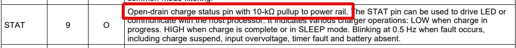

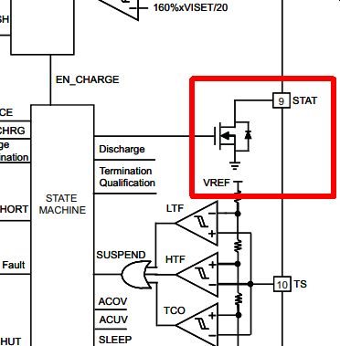

Is a pull-up register connected with STAT pin internally?
Though it is described on the pin function, there is nothing on the block diagram.
