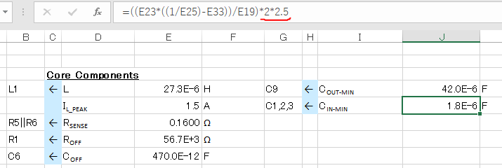

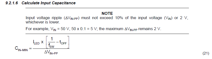

Q3.Cin (TPS92515 Calculator Rev2 vs data-sheet)
This is the equation 21 in page 23 of the data-sheet.
I calculated a CIn-min by substituting ILED, fsw, toff, ΔVin-pp, but the answer was different from the result of calculating a CIn-min by the TPS Calculator Rev2.xls.
In this calculator, an equation in the column J of row 112 is "=………*2*2.5".
Please let me know the meaning of "*2" and "*2.5"?

    2) "Does this mean that I can apply 5.5V on the Iadj pin without applying input voltage on a Vin pin?" That is not what that means. It means the abs max of the pin is 5.5V which I wouldn't apply since there is no margin however it turns out that 5.5V can be applied without Vin on this part. This is not true with all parts.
