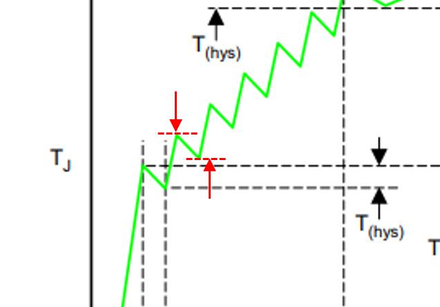

TPS4H000-Q1: Behavior during current limit
Part Number: TPS4H000-Q1
My customer is considering to use the TPS4H000-Q1.
How much degree is points of below red lines?
We would like to check if waveforms of attached file is appropriate.

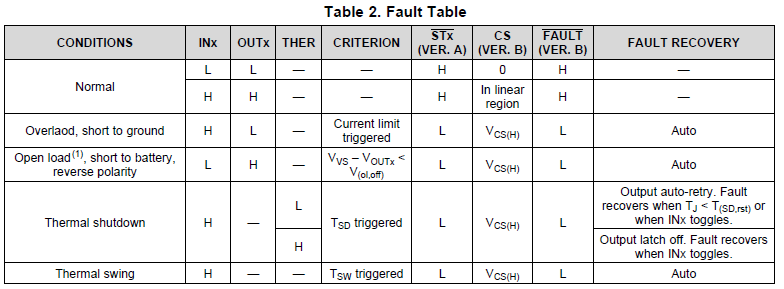

  • Kuramochi-san,
    The attached waveforms are what we would expect.
    The reason the current is turning off and on is that the device is reaching the thermal swing shutdown threshold TSW that is defined in page 7 of the datasheet as 60°C. The device reaches this point, highlighted in yellow in the image below, and then shuts off. The part will cool down Thys  and then try again due to the auto fault recovery as shown in the last row in the table below. After 1.52 seconds, the device hits TSD and the current remains off since THER is high.

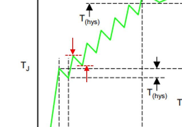

    How much degrees is raising in below?
    Kuramochi
  • Kuramochi-san,
    When the Tfet – Tlogic hits Tsw, the device turns off. The device doesn’t turn on until Tj drops Thys (10C).
    However, because the Tlogic is heating up during this process as well (not as fast as Tfet), to reach the Tsw delta, the device will have to go to a higher absolute temperature during the next retry. The device is retrying so quickly it does not have time to cool back down and eventually it gets to the TSD point where it will remain off. Since there is not a way to measure Tlogic with this device, you will not know how much higher Tfet has to go to hit the Tsw threshold. Therefore, we cannot say exactly what the rise change in temperature you're referring to is. However, I hope this clarified the process.

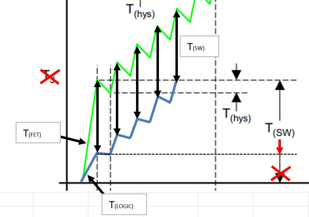

  • Elizabeth-san,
    Thank you for your explanation.
    I understood.
    I think that T(SW) on the fig.31 is not accurate.
    Is following more correct?
    Kuramochi
    How is this situation?
    Kuramochi
  • Kuramochi-san,
    Yes, your understanding is correct. Since customers do not have an easy way of measuring the temperature of the mosfet, it is easier to represent the temperature of the mosfet as the junction temperature. We will look into making this more clear in the datasheet. Feel free to email me at e-Higgins@ti.com if you'd like to know more specifics.
