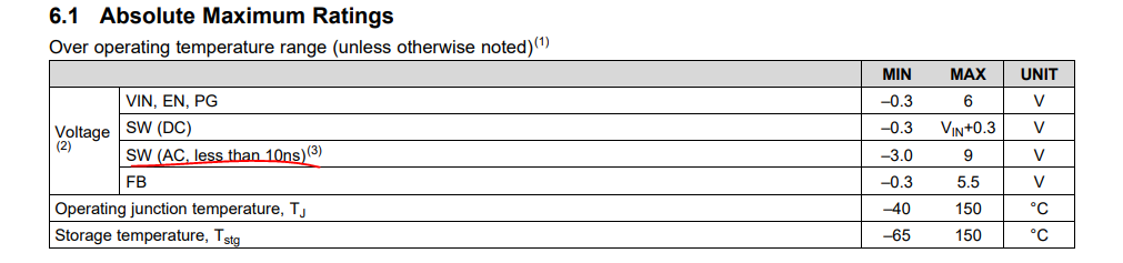

Do we have TLV62565 SW node AC specification? Becuase TLV62569 has SW AC specification like below. Thank you.

The data on SW (AC) in TLV62569 can be used in TLV62565 as a reference however datasheet update will not be implemented.
