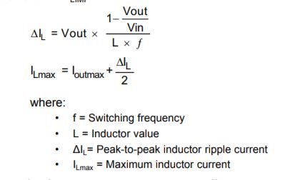

Hi team.
I'm worried about how to calculate inductors.
TPS62745 has variable switching frequency.
Could you tell me how to calculate inductors?
