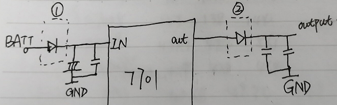

My customer uses the TPS7B7701-Q1 as a power switch. The schematic is as below,
When they test it, they found some problems,

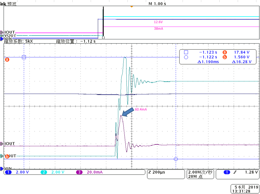

2. When the customer use this device as a power switch, the device shut down after 150s of power-on. At this time the Vsense's waveform is as below,
From the waveform, we can find that when the switch shut down, the Vsense=3.2V. According to the datasheet figure 19, the chip is in Reverse Current fault or Short to Battery fault. Could you please tell me the reason of shut-down? When does the chip detect these two faults? How often?
In addition, we also test the current as below, the rush current is 113.0mA smaller than 244mA which is the limit current value.

    In addition, we also do some tests as below,
    1. Remove the output capacitor, and then the fault is eliminated.
    2. Add a diode on the output as below, and the fault is also eliminated.
    Could you please help explain this problem, RC or STB? If the fault is RC, what is the cause of the fault? Why is it related to the output capacitors? How do we resolve the problem? If the fault is STB, what is the cause? How do we resolve it?

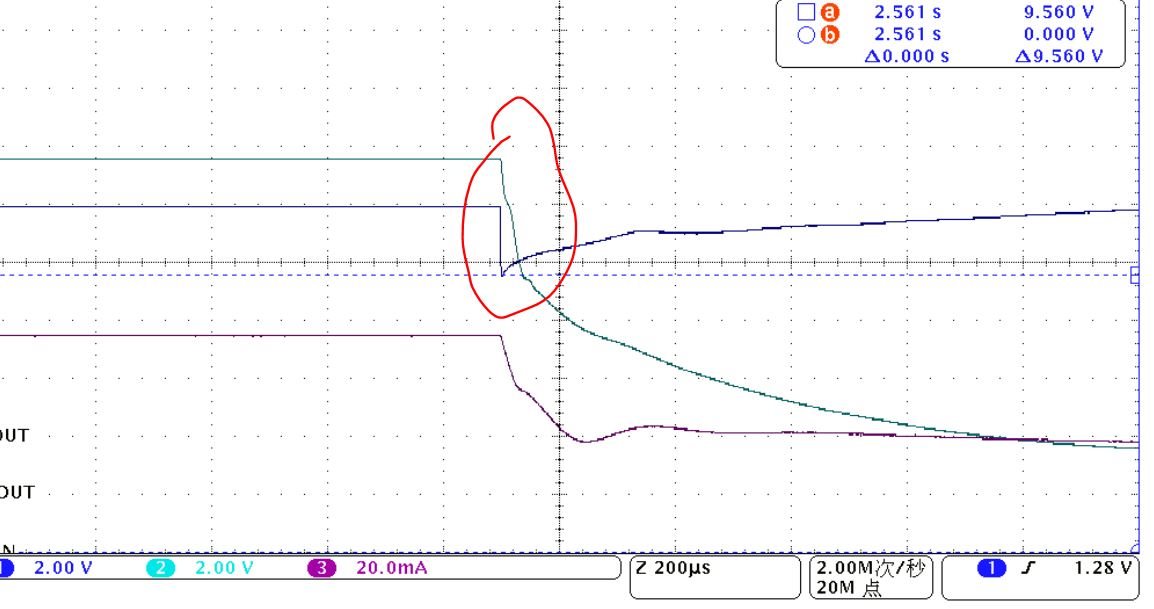

  • Hi Jason,
    The scopeshots are as below,
    1. with capacitor
    2. shut down with capacitor
    3. without capacitor
    Thanks & Best Regards,
    Sherry
  • Hi Sherry,
    Thanks a lot for providing the scopeshots. The startup with and w/o output capacitors look okay and it's not causing the problem. When looking at the scopeshot that LDO was shutting down with the output capacitors, it seems the reason for the output to latch is because of the sudden Vin drops.
    Please see the area cycled in red. The sudden Vin drops causing Vin lower than Vout as in switched-mode, Vout is equal to Vin - Vdropout@Iload. When with the output capacitor, the output capacitor will slow down the drop on the Vout and this seems to cause the reverse current event that latches the output.
    Can you help to find out at customer's boards, what happened at 150s that will dip the supply? Is it possible that the same battery is powering up other circuitry and the LDO is shutting down when another circuit has been started?

  • Hi Sherry,
    Based on the scopeshot you took, the problem seems to be that the supply Vin suddently drops. I wonder if you could find out if the supply is powering on something besides the LDO. Since in switched-mode, at no load, Vin is almost identical to Vout (Vout = Vin - Vdropout, at 0mA load, the Vdrop is near 0). With the capacitor, when sudden drop happens on Vin, Vout is supposed to follow but the capacitor is slowing things down. The voltage on Vout could be higher than Vin and this is causing the reverse current protection.
    Jason Song

    In addition, can I add a diode at the output as below? Will it influence the diagnostic function of this switch? My customer wants to use this solution to avoid the reverse current, is it feasible?

  • Hi Jason,
    1. The battery also supply other devices. So when powering on, other module drops down the input power to around 9.5V which is still in the normal range.
    2. About this questions, there are two solutions as below. Solution 1:  add a diode + An electrolytic capacitor(470uF) at the input; Solution 2: add a diode at the output.
    These two solutions both can solve the problem, but the customer are more inclined to the second option, because the solution 2 is cheaper.
    But I am not sure whether we can add a diode directly at the output, whether solution 2 will impact the diagnostic function of this device? Could you please answer this question?

  • Hi Sherry,
    Thanks for sharing the customer's feedback and providing the detailed drawing on the proposed solutions.  Instead of having the diode at the output, I would suggest to have the diode at the input. When having the diode at the input, you may still have the same intput cap you have currently in the schematic. Here are the reasons.
    1. Having the diode at the output is essentially adding additional ESR/ESL to the output capacitor. The device requires certain output capacitor and ESR range for stability.
    2. Having the diode at the input will help isolate the glitch at the input side. When the glitch happens on the supply, due to the sudden dip on the BATT, the input diode switch may become off when input capacitor is holding the voltage before the dip. Even when a load is exisited on the output when the glitch happens, the load will first discharge the output capacitor before the impacts get to the input voltage.It's not necessary to have a really big capacitor with the added diode.
    3. With the added diode on the input, it's not affecting the existing diagonostic functions of the device. When the diode is at the output side, the normal function of SENSE pin should work, but it will prevent the device to show the RC or short-to-battery as the diode is blocking those events from being sensed by the LDO.

  • Hi Jason,
    1. If adding a diode at the output, this device won't detect the RC function, I understand this. But I don't understand why this diode will affect the short to battery detection which can be achieved by comparing Vin and Vout. The diode will only affect the voltage B.
    2. About the output capacitor, you mentioned before, it will affect the current limit loop. Could you please help explain more details about this?
    Sherry
  • Hi Sherry,
    -- You are correct. If the short-to-battery is happening at point A, the device is able to detect it. But for real application, considering the cable is indeed in a car's chassis, a short-to-battery is likely to happen with worn-out cables and it's far from the LDO. It's less likely the short-to-battery can happen at point A.
    -- In a linear regulator, there are multiple loops in design. An easy way to understand current limit loop is that it's one of the loops that control the pass-FET, when the output current exceeds a certain threshold, the current limit loop will turn off the pass-FET switch to reduce the output current. You can also consider this as a negative feedback loop and a negative feedback system requires certain conditions to be stable.
