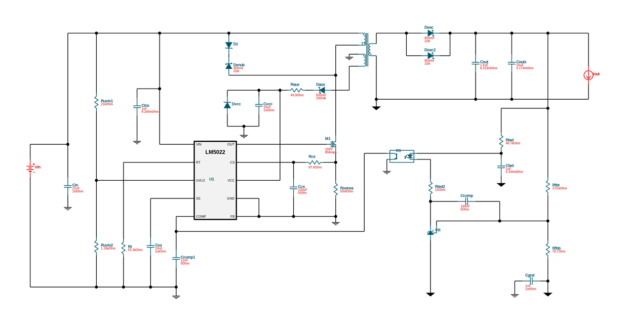

I need to design an isolated flyback converter with the following requirements:
Nominal Input voltage: 24V
Output voltage: 48V
Max Output Current: 0.6A
I have this webench design passed to me from another engineer =>  The problem is I don't know what parameters were used in generating this design and haven't been able to find any information detailing how it works (i.e. what resistor would I change to control the output voltage). Is there is any information available that might be useful in verifying this design for my application? Otherwise I will likely have to scrap this one and generate a new design altogether.

  • Once I generate a design where can I find more information on that design? Each of the designs I generate list the flyback transformer as "custom", but for our application we will likely want to leverage a standard component. We need more information (i.e. the relationship between Vout and Rfbt) that would enable us to tweak the design for our needs.
  • To add to that, let's say we were to use Coilcraft PA6582-AL as our isolation transformer for example. Its designed for PMP20588 and rated for 54V output. How would we alter the design to generate a 48V output instead of 54V output?
  • Hi Josh,
    You are right that you can tweak a webench design for your real application needs. Basically you should contact the magnetics vendor and ask them to provide you a proper flyback transformer.  A proper design is always the results of iterations and trade-offs.  Once you obtained a transformer, is not exactly the same as your initial design, you need to readjust the other components.
    Regarding the Coilcraft transformer, you can change the feedback resistor R25 or R26 or both of the PMP20588 to get 48V output.
    Youhao
  • Is there an equation that relates Vout to R25 & R26? How do I determine what resistor values are needed to generate a 48V output?
  • Hi  Josh,
    Vout is set by the resistor ratio of R21 to R25//R26.  They should be selected such that when Vout is at your desired set point, the voltage across R25//R26 should equal to the TL431's reference voltage.  If you are not familiar with TL431, please study the datasheet.
