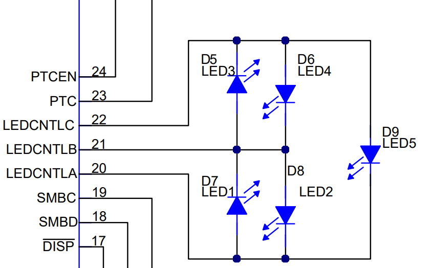

Hello, I want to configure 5 Leds to show the RSOC of the battery according to the next table :
The gas gauge has 3 outputs ( LEDCNTLA,LEDCNTLB,LEDCNTLC)
Does the right placement for the 5 leds in order to achieve the RSOC indication above is as it appears in the Evaluation Module?( image below)
LED 1: ANODE :LEDCNTLA   CATHODE :LEDCNTLB
LED 2: ANODE :LEDCNTLB   CATHODE :LEDCNTLA
LED 3: ANODE :LEDCNTLB  CATHODE :LEDCNTLC
LED 4: ANODE :LEDCNTLC   CATHODE :LEDCNTLB
LED 5: ANODE :LEDCNTLC   CATHODE :LEDCNTLA
