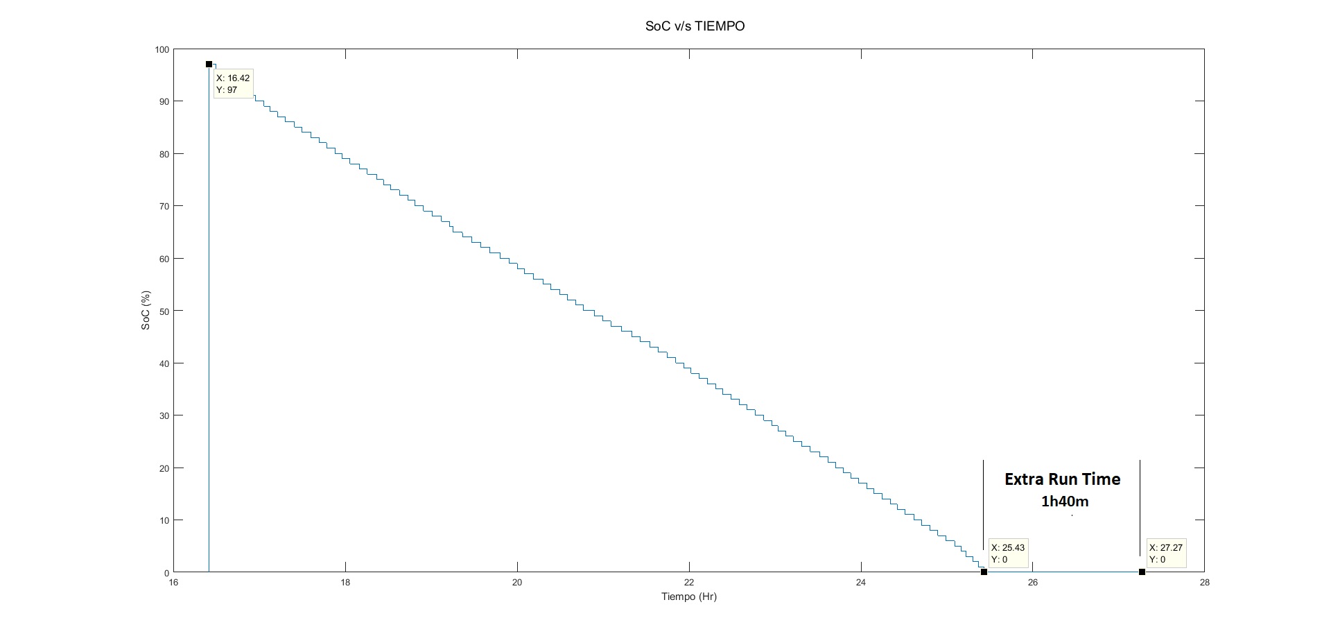

I have a LiCoO2 battery with a maximun charge voltage of 4.2[V] and 4000[mAh] of capacity. The load consumes about 6[A] for 3[ms] and then go to rest for about 2[s].
Im not sure about the value of the sense resistor that I have to use because I put the recommended 10[mOhm] value, but sometimes BQ reports me 0% of SoC but battery keeps running for about one hour more until voltage reaches 3.0[V].

  • Hi Onyx,
    thanks for your answer.
    I did not run gpc chem, just followed the quick start guide instructions to set the registers. Maybe some value in data flash is wrong.
    How ever, this is not a regular issue. I mean, in some discharging test I've been able to observe the problem (see the picture below)
    However, I will run gpc chem to be sure and double check the settings in data flash.
    But, still my question is do I need to calculate the sense resistor for a better accuary?. It is because, if I'm not wrong, the full load current that I can measure with a 10 miliOhms resistor is (differential_voltage/Rs)=50[mV]/10[mOhm]=5[A]. But for my devices I need to sense 6[A] at full load.

  • Hi Carlos
    I don't believe you can use this gauge. The minimum sense resistor recommended is 5 mohm and max is 20mohm
    The max current the gauge can support is actually 25 mV. So with a 5mohm sense that puts you at 5A. You need a gauge with 0.125mV like the bq27520.
    thanks
    Onyx
