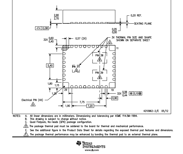

looking for the dimensions of pins 37, 38 and 39 on the part LMZ30606. The drawing for that part says the thermal pin size and shape are shown on a separate sheet. I am not able to locate this document, are you able to help me locate it?
Hi Robert,
Our team is currently working to get the additional pages appended onto the datasheet. I've attached the RKG39 mechanical drawing to further illustrate the thermal pad dimensions.
This should provide good reference to answer your question.
