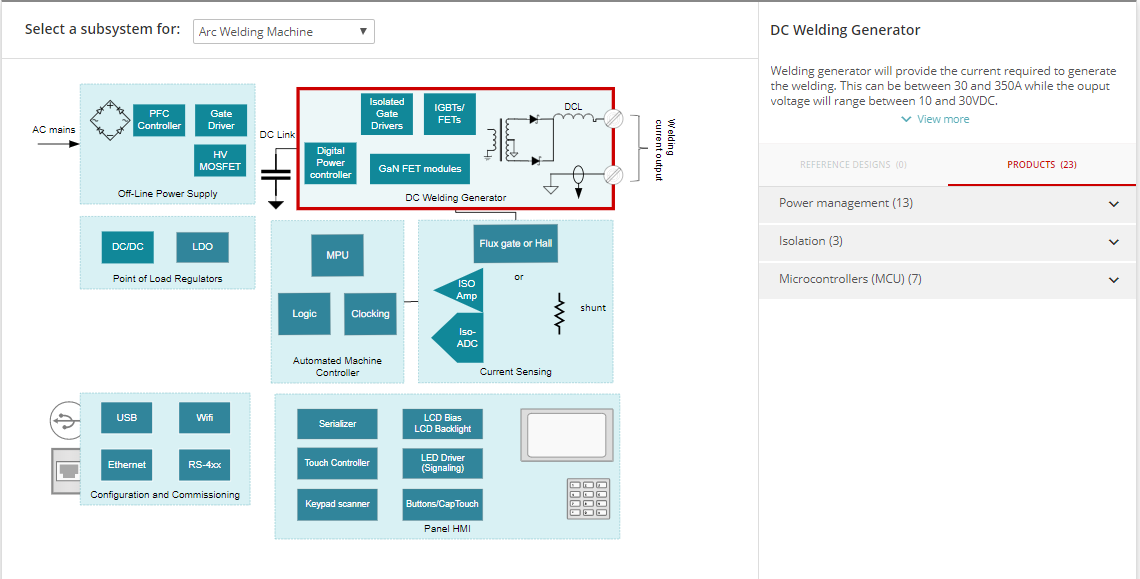

    To replace the brute force transformer method for welding, with an electronic design, is no trivial task.
    Linear regulators can not be used in the main power path because they will waste copious amounts of heat.
    See this TI DESIGN for what it takes to create a welding machine.
    Granted it is Arc Welding but the currents are very similar.
    http://www.ti.com/solution/welding?keyMatch=welding&tisearch=Search-EN-Everything

    From an electronic standpoint, the reference design I showed has the required power blocks.
    An electronic design will need to mimic what the old proven transformer method does, while also providing optimization of the welding process that the transformer cannot do.
    1. Power Factor Correction switcher on the input. This allows you to draw full power from the AC line.
        You may not need 3 phase if you use PFC.
    2. PFC output then goes to another switching stage that provides the lower voltage for welding.
        The second stage also provides isolation, as the existing transformer does, for safety reasons.
