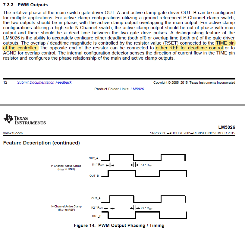

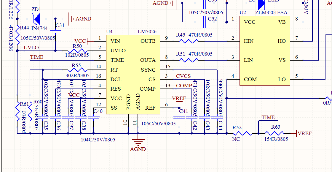

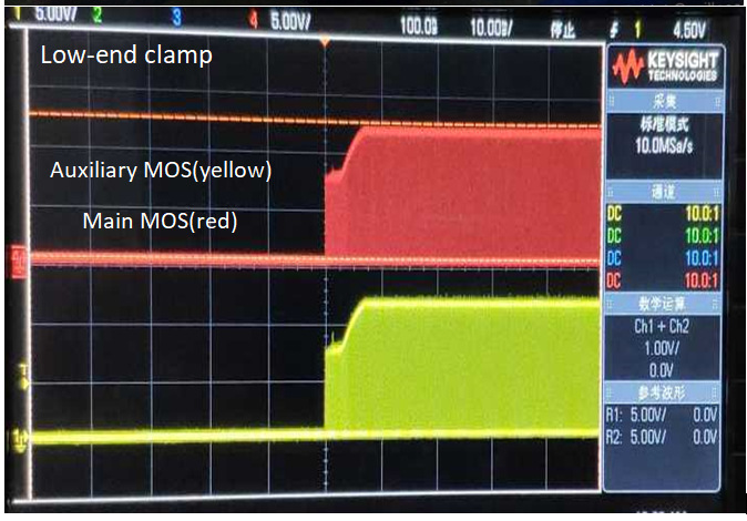

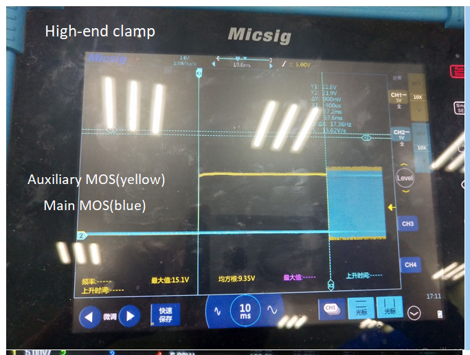

When LM5026 is used for high-end clamp, the driving signal of auxiliary MOSFET has a 60 ms constant high voltage at startup. The schematic and test waveform are as below. Is this phenomenon normal? Because when using 5026 as low-end clamp, I can't see the 60 ms high voltage at startup. So can you please do the same test with EVM and then explain the difference between high-end and low-endclamp phenomenon?
