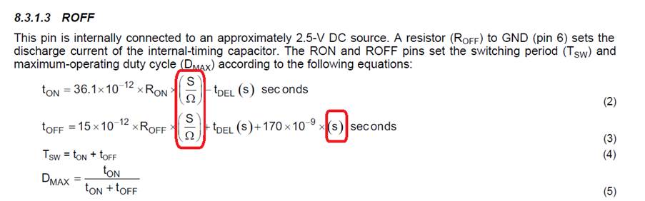

I would like to consult with you about the red circle part of below figure.
In the ton formula, there is S/ohm symbol . Is it only the unit symbol ?
Or I need to substitute any value in this formula.

Hello Ben,
Yes you are correct.
With units of resistance in Ohms and time in seconds, Ton and Toff will also be in seconds.
