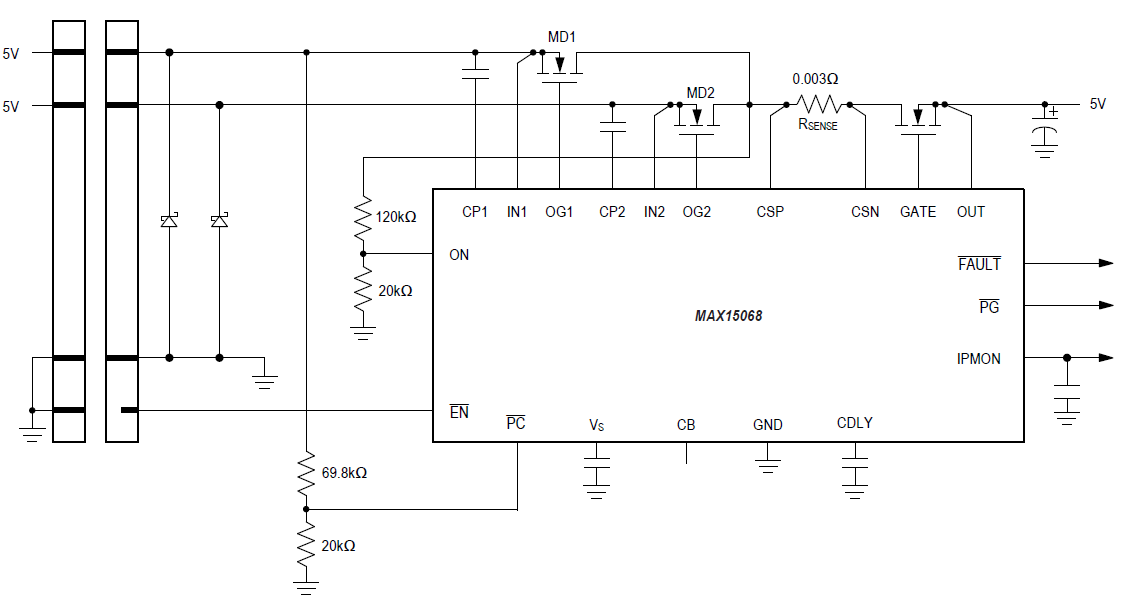

May I check which IC will be suitable one to replace MAX15068?

Hi Kevin,
If the currents are between 4A to 5A, we can propose integrated solutions TPS2121, TPS2594x
TPS23525 operation range is 10V to 80V. So, the closer device to offer against MAX15068 is TPS2456
Rakesh
