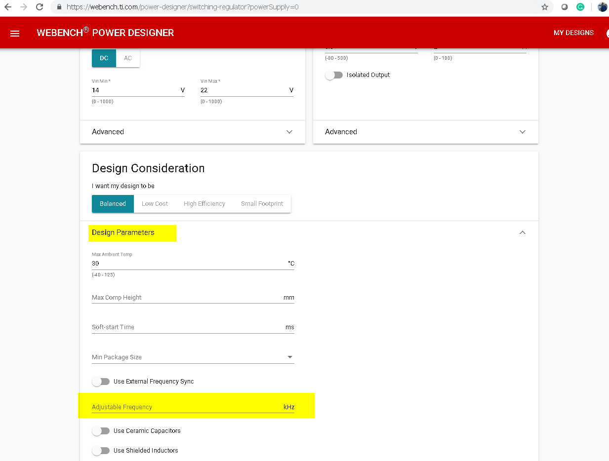

  • Hi Praveen,
    Got it, thanks for your explaination in detail.
    Now the question is, how can I use Webench "auto" calculate frequency for the input parameter?
    Or I have to calculate myself and use "NEW DESIGN" to key in the calculated frequency for design creating?
    Thank you very much,
    C.T.
  • Hi C.T,
    Please calculate the frequency using the above equation and enter the value as design parameters shown below.
    Thanks & Regards,
    Praveen B
