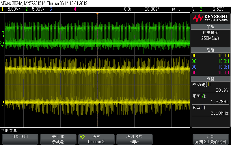

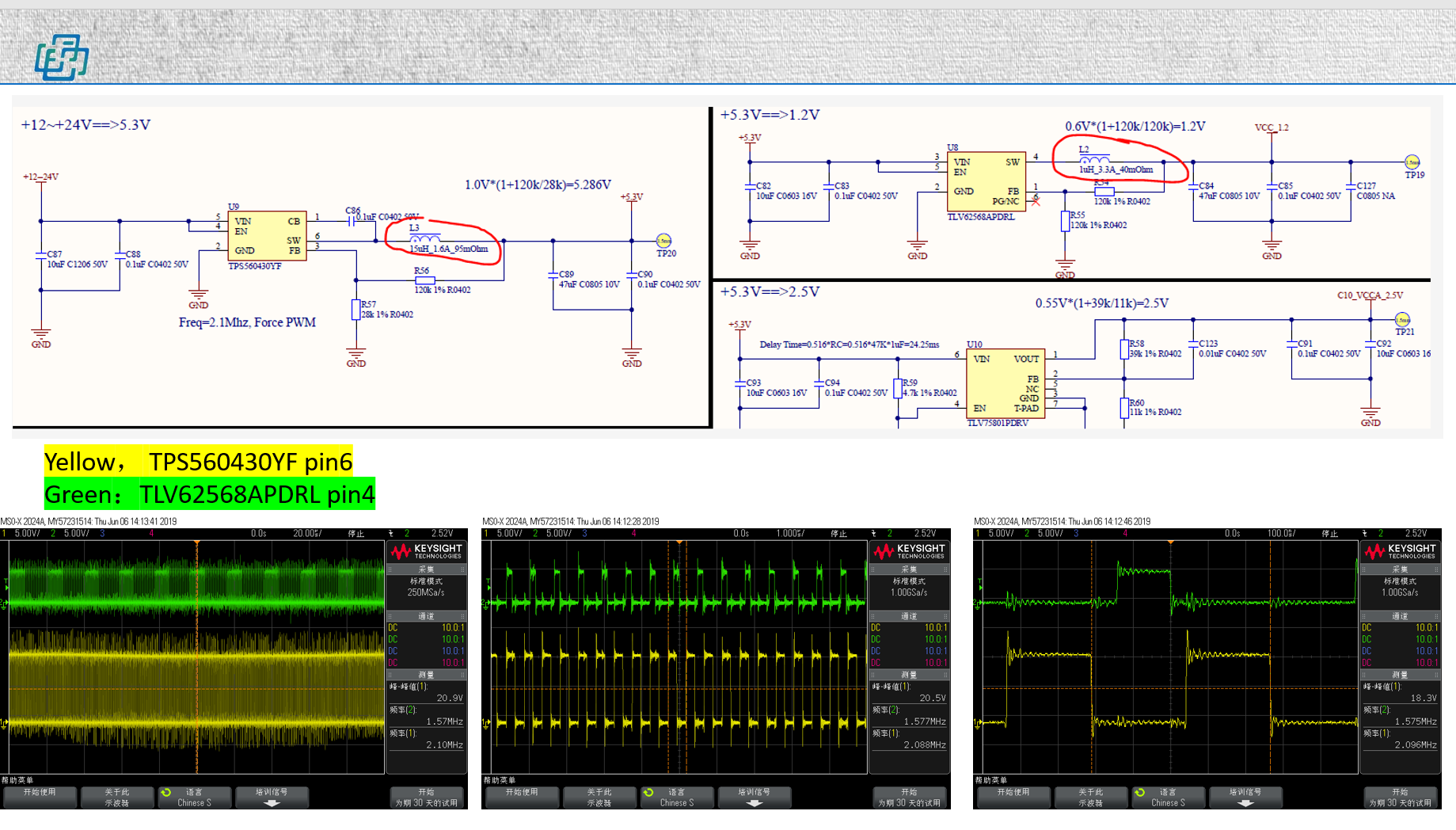

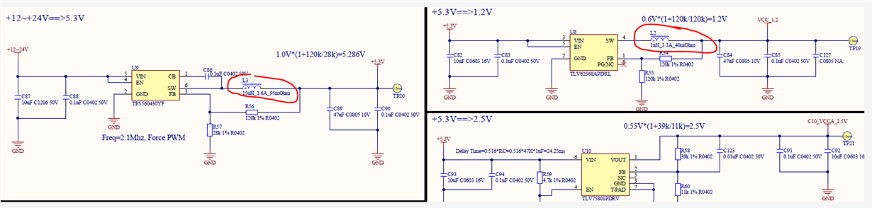

When using the TLV62568 and TPS560430, the test found that its output inductance whistle, please help me to see what good way to solve? Thank you very much!
Hi Jerry,
What do you mean by "output inductance whistle"? Do you mean it generates audible noise?
Can you capture the SW pin (pin 4) waveform of TLV62568? This is determine if the switching frequency is within the audio frequency.

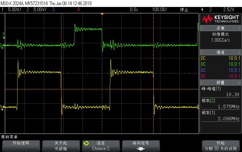

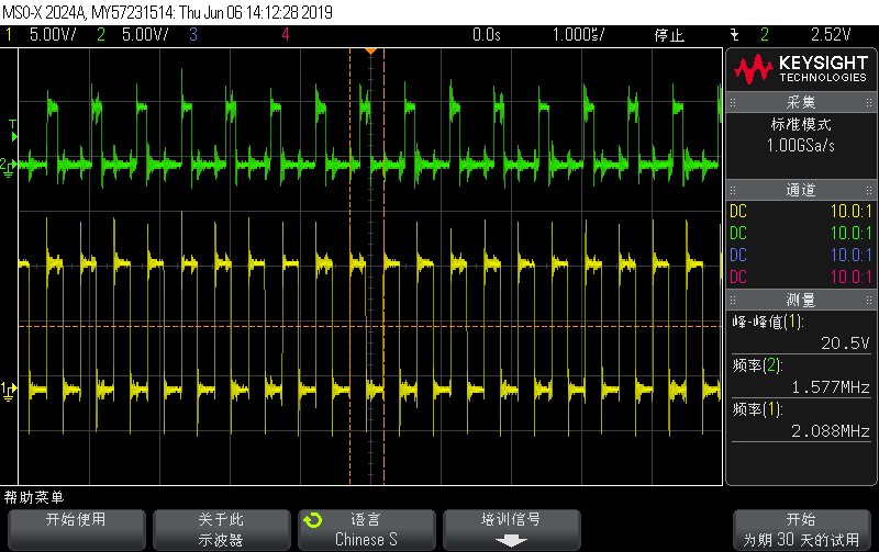

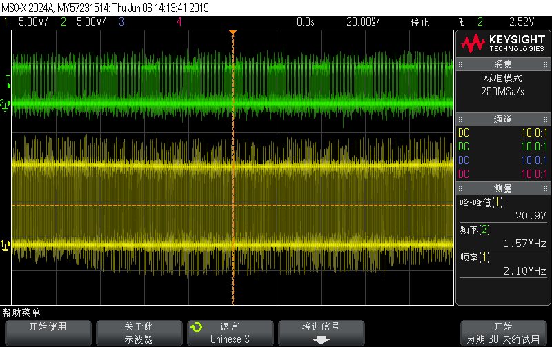

If my understanding is correct in the waveforms you provided, the TLV62568 and TPS560430 switching frequencies were 1.5MHz and 2.09MHz, respectively. However, the switching frequencies were above the audio frequency spectrum (20Hz - 20kHz) therefore will not generate audible sound.
Can you please clarify if your issue is related to audible noise generated by the circuit?
