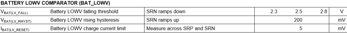

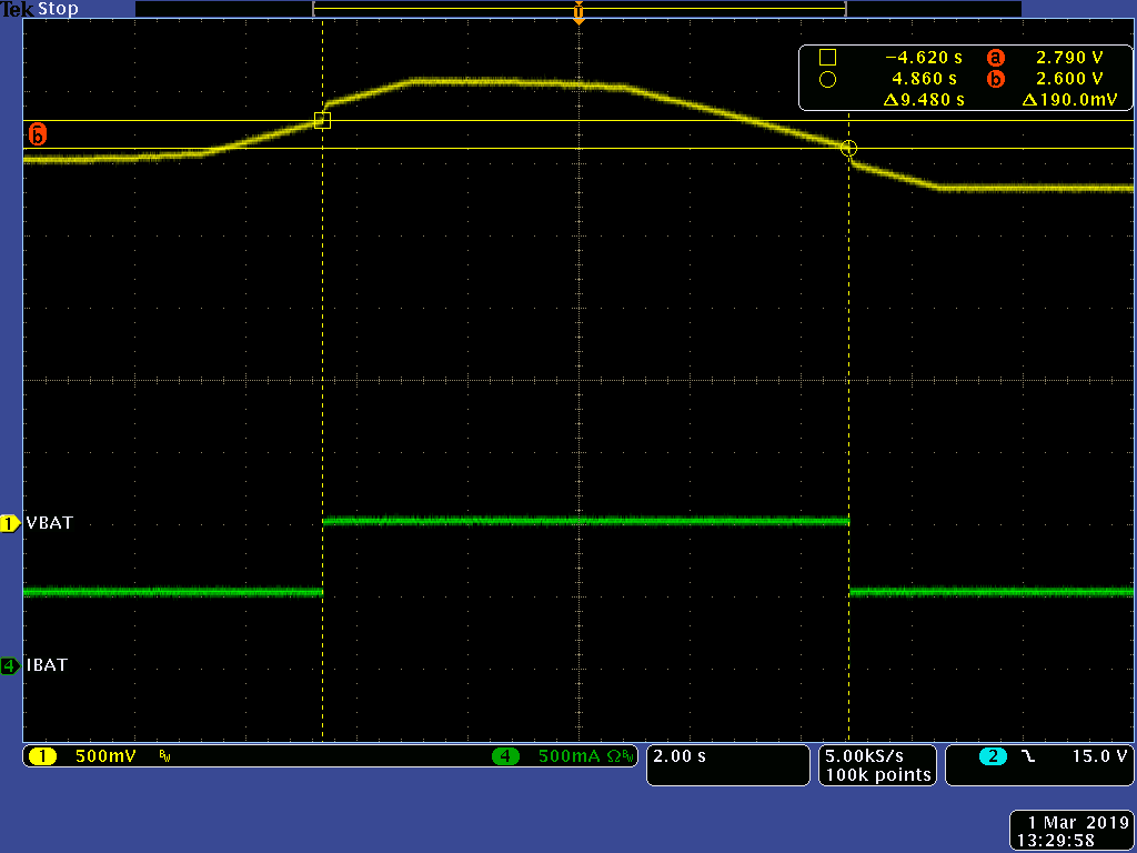

    1) The BQ24780S will automatically apply pre-charge current when VBAT < BAT_LOWV. No MCU command is necessary (although the Charge Current and Charge Voltage registers must be non-zero). The rising threshold of BAT_LOWV is 2.7 V, and IPRECHG is set by a 5 mV drop across the Rsr sense resistor (please see the table below). This corresponds to IPRECHG = 0.5 A with the default Rsr value of 10 mΩ.
    To help illustrate this, the waveform below shows the behavior as VBAT rises above BAT_LOWV, at which point the BQ24780S applies a 1 A fast charge current. When VBAT falls below BAT_LOWV, the BQ24780S applies a 0.5 A pre-charge current instead.

    3) The charger detects VBAT through the SRN pin and uses this voltage to determine whether to apply pre-charge current or fast charge current (see the comparator below).
