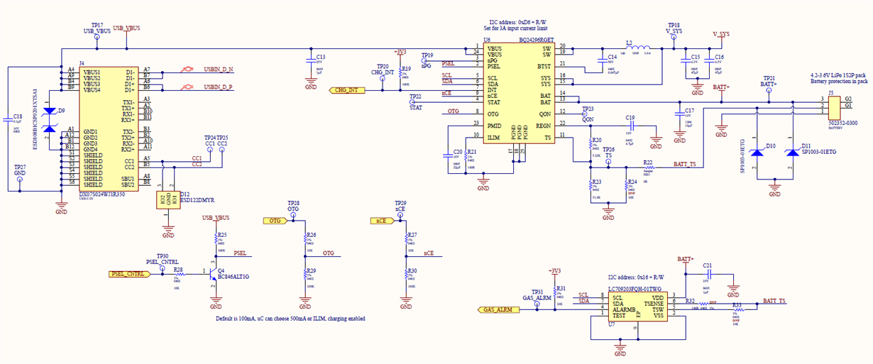

I have been debugging our battery charging schematic that uses the BQ24296 IC, however I have not been able to get the system to reach ‘Fast Charge’ mode.
No matter what settings I change, the system always remains in pre-charge mode, with no fault, and REG08[0] is 1 when read (VSYSMIN regulation).

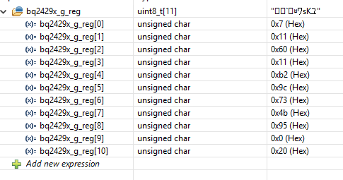

Please see the schematic and snapshot of the register values (below) taken during debugging (bq2429x_g_reg[0:10] in the image follows the same order as REG[00:0A]).

- What is the meaning of REG08[0] (VSYS_STAT)? It says that this bit is 1 when BAT < VSYSmin, however our VBAT is 3.97V and our VSYSmin is 3V (REG01[3:1]), and yet this bit is 1.
- What is supposed to be the value of EN_HIZ bit (REG00[7])? I have found out that if it is set to 1 the chip charges (even if it does not switch to Fast Mode), otherwise it does not.

    It came out that D10 (protection diode) was causing an issue (it reduces drastically voltage of TS).
    If you follow the schematic provided with this thread, do not populate that diode and keep HIZ low.
