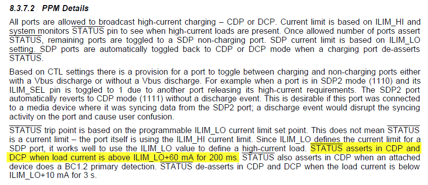

My customer wants to use the status pin to realize a feature to boot the system the first time if the current drawn from 2547 power rail is larger than 300mA.
I suppose this can be realized by regulating the ILIM_LO setting right?
But also seems that there is still another current threshold as 45mA and 55mA for the load detect also works and change the Status pin level. Could you help to explain to me how the status pin is triggered please?
If the 45mA/55mA is the threshold? Or any situation that the ILIM_LO and the 45/55mA are separately used?

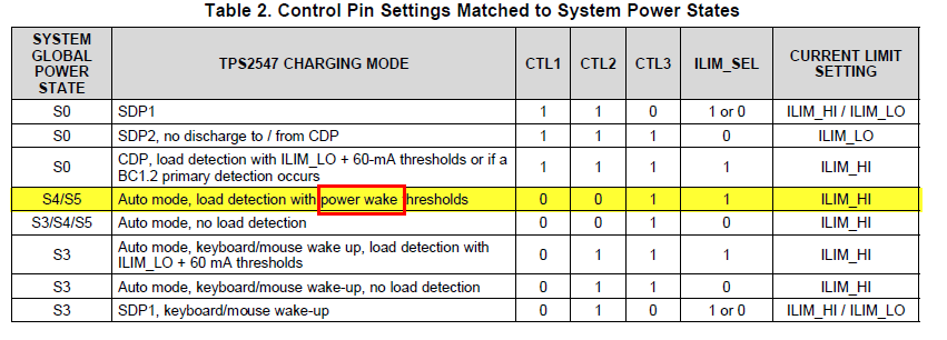

  • Hello Max,
    The 45mA threshold you are referring to is for the Power Wake feature built into the device, which can be read in section 8.3.6 of the datasheet. This feature is only enabled when the device is in S4/S5 power state
    All other configurations, the STATUS pin is set based on the PPM feature which determines when STATUS goes low based on threshold set by ILIM_LO + 60 mA. So for your customers application, keep the device in CDP charging mode or DCP_Auto with the ILIM_LO + 60 mA current threshold and your customers system should be fine.

    1. The 45mA trigger point is related to the power wake function. And there is also another USB wake feature. Are they related or totally different? Could you help to explain how the USB wake (mouse/keyboard wake) is realized please?
    2. We keep ILIM_LO pin as floating, so ILIM_LO=0, means that ILIM_LO+60 mA about 60mA when no BC1.2 primary detection?
    3. When doing BC1.2 primary detection, what suppose to be the trigger point of STATUS pin ? Is it defaulted at 45mA power wake value or ILIM_LO? Or maybe depend on the real time CTL and ILIM pin levels?

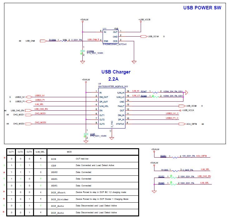

  • Hi Adam and team,
    Double confirmed with customer that in CDP configuration and system S0 status, they monitored that the configure pins and Vbus not changed, but the status pin will pull-low sometimes in the case that nothing is connected to the USB-A port and and ILIM_LO is floating, this has been the issue need to be cleared very soon.
    Below is the schematics, could you help to confirm if there are any posibillities that can trigger the STATUS pin? Please let me know if you need more test to clarify.

  • Hello Max,
    Your customer needs to populate a resistor on ILIM_LO. As outlined within the datasheet, this pin is optional if the following two criteria are met.
    1. ILIM_SEL is always set high
    2. Load Detection - Port Power Management is not used
    Since your customer does not meet either of these requirements, they will need to populate the resistor on ILIM_LO. This should fix the issue.
