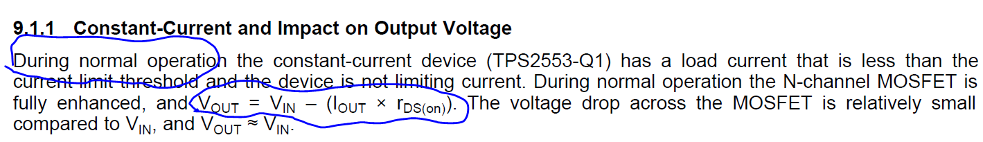

Had a query on how the output values varies with the variation in surrounding temperature.A characteristic curve or a tabulation will be helpful. The temperature will vary in the full operating range as recommended.

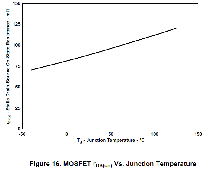

    We don't have the curve in the datasheet.
    I think the curve of Rds(on) Vs temperature may be helpful.
    For details, please refer to the datasheet.

  • Hi Aishwarya,
    For the curve on datasheet, all has been acquired by ATE test results which standby required standard and test many parts.
    I look up the datasheet and can't find the curve you required.
    But I think the Rdson is sure to  influence the output as temperature varies.
    You can get the Vout variation according to the fomula above.
