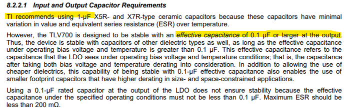

  • Hi Shlomi,
    From your description it sounds like the TLV700 is not stable in your application.  When you are using a 0.1 uF capacitor, you are not meeting the minimum effective capacitance required to compensate the LDO.  As you increase your output capacitor's nominal value, you are adequately compensating the internal loops and are able to achieve a stable output.
    Please refer to Chapter 2 of our LDO Basics Blog for more information on Capacitor vs Capacitance:
    http://www.ti.com/lit/ml/slyy151a/slyy151a.pdf
    Very Respectfully,
    Ryan
  • I agree, but with 1uF I faced the same issue. Seldom but anyway. Only with 4.7uF it looks stable and it is strange
  • Hi Shlomi,
    You will need to look into the derating of your chosen capacitors under your application conditions.  Just because a capacitor states 1 uF does not mean that you will have 1 uF of capacitance under your use case.  Your statements about increasing the capacitor value reducing and solving the issue indicates that your specific application requires the higher capacitor values.  This will be due to how your selected capacitors derate and the transient response to the impulses you mentioned in your first post.
