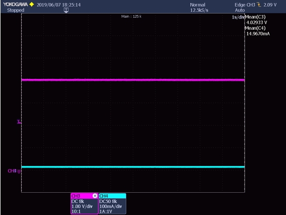

Even if REG07 bit 4 is set to "0", ChargeVoltage does not become 4.1V.
The following is the waveform of the charge voltage and charge current after NTC_FAULT = "010" (45-60 ° C) and CHRG_STAT = 11 (Charge Termination).
The charging voltage is 4.02933V instead of 4.1V
Is this correct behavior
And VSET has the following three values. What is the actual value?
