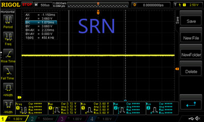

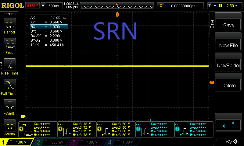

       When VIN is between 0 to 4.2V most likely the charger is in SLEEP mode where if input voltage is lower than SRN, then the IC will enter a low quiescent current mode. From calculating your MPPSET values, you have 2 MPPSET thresholds, at 4.289V (75k||39.2k top, 10k bottom) and at 4.704V (39.2k top, 10k bottom) where the 4.704V threshold is for the solar panel, and the other 4.2V threshold is for the USB right? What do you mean by MPPSET low limit and high limit?
         When STAT1 is blinking, can you take a scope capture of STAT1, VCC, SRN and PH? For all signals captures, probe pins as close to the IC as possible.
    In order to be sure the charger is working correctly, I want to change the MPPSET threshold when I plug the USB source. My first MPPSET threshold for solar panel is (39.2k top, 10k bottom) 1.2*(1+39.2/10) = 5.904V.
    For the other threshold (75k || 39.2k top and 10k bottom) , as you mentioned it is 4.289V.
    What I mean by MPPSET low limit and MPPSET high limit, I measured the voltage at this point while ramping up the VIN voltage. I noticed the STAT1 stop blinking when this voltage (V_mppset) is out of the range 175mV and 1.2V.

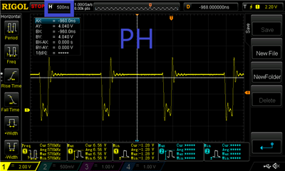

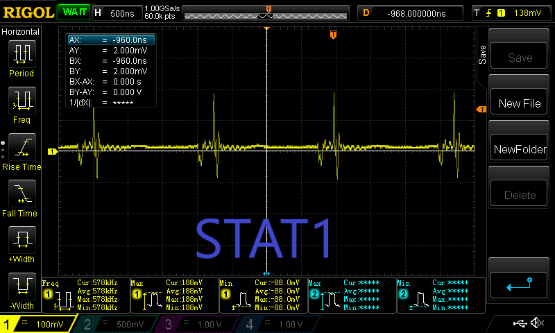

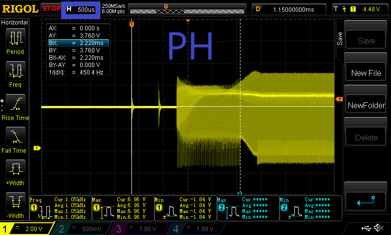

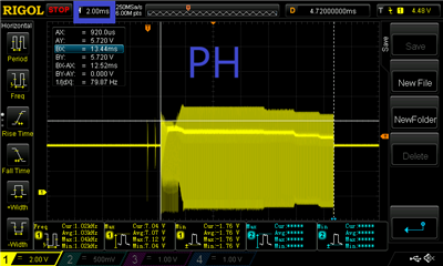

    You can see the scope capture of STAT1, VCC, SRN and PH when STAT1 is blinking. The parameters are : V_USB = 5.1V / VIN = 5.1V and V_USB connect to VIN.
    There is multiples pictures of PH voltage measurements (different time scales) since I suppose this behavior isn't right.
    One thing that can be a huge information to take into account is when I scope the MPPSET with a probe to my oscilloscope, the charger is working properly, but when I don't, the charger goes back in fault mode.
    Could it be an impedance issue since when I connect my probe to MPPSET the input impedance is changing?
    Best Regards

  • Hi Julien,
        When MPPSET is below 1.2V, this means the charger is in MPPSET regulation and trying to regulate the voltage. In this voltage regulation loop, the input voltage is regulated, and charge current is reduced to maintain input voltage at the MPPSET point. Most likely your transistor implementation of MPPSET is not working as expected when USB is connected. Looks like the MPPSET point for solar panel (this input source operates correctly) is also being used when USB is connected, causing charger to be in input regulation until you ramp up the input voltage. What is the input voltage and MPPSET voltage at the moment STAT1 stops blinking and charging occurs normally?
