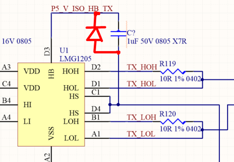

  • Hi John,
    That is really helpful, thank you for your response.  We had considered adding an isolated power supply,but weren't fully sure how to do this, for clarity, I have sketched out the connections into the LMG1205.. is this where you would expect to connect the isolated supply into the circuit?
    Kind regards
    Mike
  • Hi Mike,
    Those connections look correct; +5V connected to HB, digital GND connected to HS, directly across C194.
    If you are worried about how the isolated supply and internal bootstrap diode will interact with each other, it is possible to isolate the internal bootstrap diode by placing another diode with anode on C194, and cathode on HB. The isolated supply would still be placed directly across C194.
    It will be important to ensure that routed area for this circuit is kept low, in order to reduce the parasitic capacitance placed on the switch node.
    If this answered your question, could you please press the green button? If not, please feel free to ask more questions.
    John
  • Hi Mike,
    thanks for your reply, I work with John and will try to help out.
    That correct, you may have to put a current limiting resistor in series with the output to keep HB within reasonable limits if there is ground bounce or during power up when the bootstrap current is highest. Standard bootstrap considerations will still apply since ground bouncing can increase the bootstrap voltage, which can stress the high-side supply. However the high side UVLO startup delay will no longer be there due to the isolated supply being present.
    If 100% duty cycle is used, VDD quiescent current continues to draw. This current is sourced by the bootstrap capacitor. Over time, the bootstrap capacitor will be depleted. 100% duty cycle is possible as long as the VDD voltage remains at an acceptable level. Increasing the size of the bootstrap capacitor increases the stored charge, which increases the duration for which 100% duty cycle is possible. If indefinite high side 100% duty cycle is required and a 99% duty cycle can’t be used to periodically replenish VDD voltage before it falls below an acceptable drive level, or below the VDD UVLO threshold, a separate isolated supply will be required for the high-side driver which will need to be able to constantly supply current per the larger value of the bootstrap capacitor.
    please let me know if you have any more questions!
    thanks,
  • Thanks John,
    We were a little concerned about that, I will put a placeholder in the circuit for a diode as described..just for safety.
    We will also look to minimise the circuit size as much as possible and aim to minimise parasitics where possible.
    Really appreciate your input here, thanks.
    Also, thanks to Jeff for the response below, I will add a series resistor placeholder to allow for some experimentation here if required.
    Kind regards

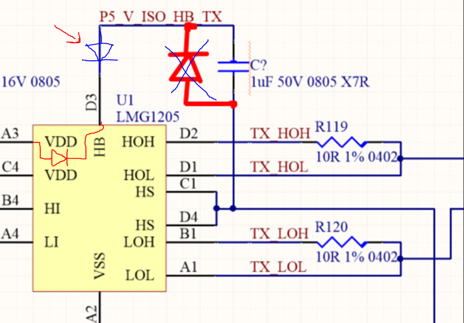

  • Hi Mike,
    Sorry for the confusion, but the diode drawn in the picture above is in the wrong place.
    I meant to add the diode as drawn below. I also drew the internal bootstrap diode just to help show what this blocking diode is meant to do.
    John
