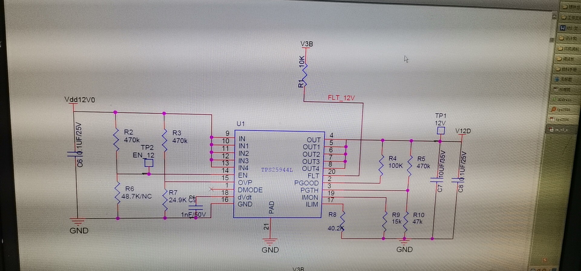

Dear,
    now our customer use TPS25944L as a power protection unit, IC's input powered but output can not powered and IC has not report an error, just donot have output;
    this kind of phenomenon is an accidental failure, our customer wants to resolve this problem. do you have any functional suggestion?
    schematic has below:
