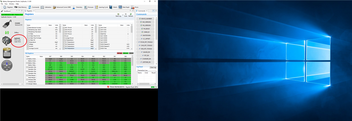

I do an upgrade firmware to BQ40Z60 from .13 to .15 version.
The upgrade seems to be failed for an unknown reason.
The worst thing is that i have NO MORE access to the chip. BQ40z60 does not respond to any SMB access. The chip is not seen on any SMB address.
Do you have a rescue procedure in that case ?
Gilles

    Please probe the device at addr 0x16. If you get a response, it means the device is in ROM or fw upgrade mode. You can still flash the new fw. However, you will have to manually open bqstudio and select the device before you do it as it will not auto detect.

  • Hi Gilles,
    Was this manually selected or did the device open up with such an ID when you opened the software?
  • Hi Batt,
    No, it's not manually select
    It appears when BQstudio start and display the bad ID.
    But after 3 or 5 seconds, the ID disappear and the left column show nothing (same as no device detect)
    Gilles

  • Hi Gilles,
    Fw corruption can occur if GND is not connected first to the device. Normally this is seen as dataflash corruption. If instruction flagh is corrupted then you can't recover the device. The bq40z60 has been used for many years now. However, due to layout and design sensitivities we suggest using the bq40z50 and a dedicated charger for people with less experience with gauges.
