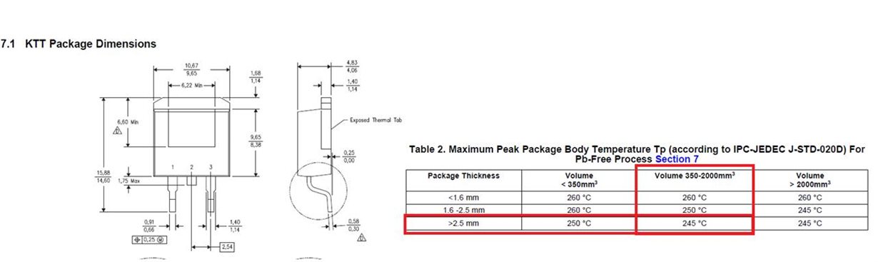

Hi Experts,
What's the reflow temperature of CSD19536? 245 °C right? thanks.

Hello Han Lee,
Thanks for your interest in TI FETs. I am checking with our SMT experts to confirm that 245C is correct. I will get back to you as soon as I have a response.
Hi Han,
The CSD19536KTT is rated for a peak reflow temperature of 260 degrees C. We recommend that the customer follows the solder paste manufacturer's guidelines for the reflow profile used during assembly.
