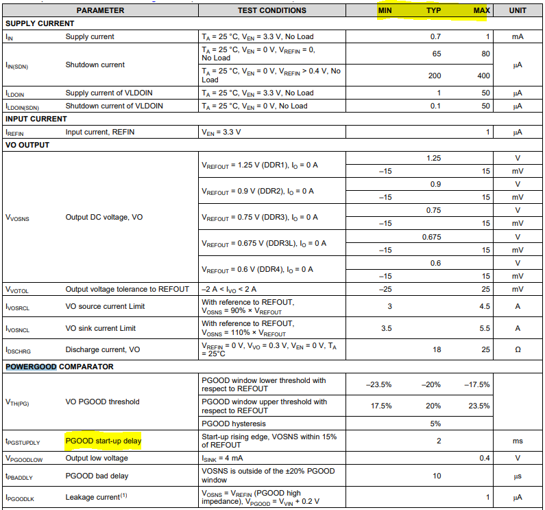

TPS51200: Maximum Power Good Delay
Part Number: TPS51200
Dear Team,
May I know the maximum power good delay?
