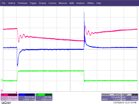

Hi Guys
I would like to get some information/Graph on TPS7A7001 Load Transient response to assess my design. Vout=3.3V, ripple vs Iout

Hi Guangyi,
Transient performance will be dependent on application specific data including your Vin, Vout, Iout, capacitance, and even parasitics from layout. Please find some load transient responses for you to reference taken on our EVM.
If you have a prototype board, we encourage that you perform your own transient testing on your board. Otherwise TPS7A7001EVM-065 can be used early in the prototype phase.
