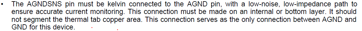

Customer is confused for below layout guider. Could you show him a diagrammatic drawing about the Kelvin connected between AGNDSNS and AGND for TPS544B20?
Thanks.

Oliver,
Please see the enclosed diagram which details this connection.TPS544B20 AGND.pdf
