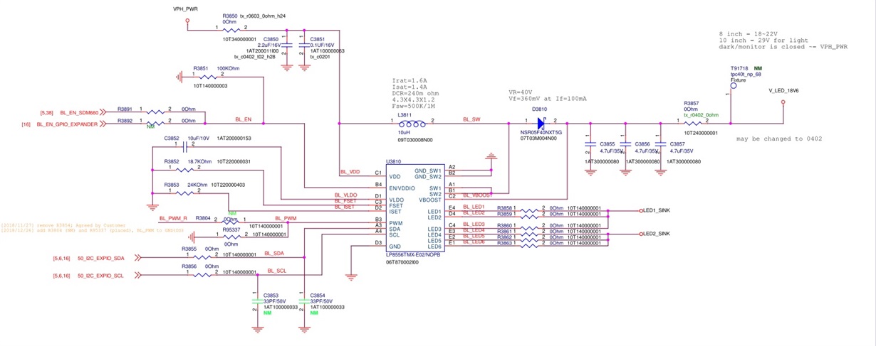

    We use LP8556 LED driver to control backlight LED currents of display panel In our tablet product.
The schematic is as following:
However, the brightness is controlled by I2c interface.
And as display panel requirement, we need set 26.67mA for LED1~LED6.
We also tried to set “boost inductor current limit” to reduce power consumption
So following is our register settings:

    And we use following formula to get measurement result 1037mA :
        Vout = 22.18V,  Iout = 159mA
        Calculate back to Vin (VPH_PWR=4V)
        4V * I input * 0.85 = 22.18V* 159mA
        I input = 1037mA
    However, Can you please help to answer below 3 questions ?
    1. Is our formula for measurement result reasonable ?
    2. For reduce power consumption, we set  register "0xa7>"  to "<0xf5>  for boost inductor current limit. And this modification really can improve  power consumption. Can you please help to check the setting is correct ?
    3. We also found it can improve power consumption by settings  "VBOOST_RANGE = 0"  in register "A9h".  but in the document, they said the preferred value is  "VBOOST_RANGE=1". Can you please check is there any side effect if we set "VBOOST_RANGE=0".

  • Hi Joe,
        1. the calculation method is right;
        2. No this wrong, if you set the current limit at low level, it may effect the average output current; you can compare the output current when you set the different current limit;
        3. I think that;s ok for your application, you can set the "VBOOST_RANGE=0";

        No, I mean the boost switching frequency, you can try to change the reg A6 bit[7][6].
    Sean

    This is power team Chanah.
    SW Joe had tried to change the reg A6 bit[7][6], but it will cause flicker and brightness has been reduced.
    If we keep default setting, VBOOST_RANGE = 1 and IBOOST_LIM = 11 (1.8A)
    Our max. backlight would be 1448mA, min. backlight would be 234mA.
    It's mean backlight max. current consumption = delta 1214mA.
    But from our display datasheet, the max. current consumption = 3.998W.
    4V * Iin * 0.85(eff) = 3.998W
    Iin should be under 1176mA.
    Is our efficiency set too ideal ? or is there any register need to adjust ?
    We hope can reduce the consumption but cannot cause flicker..
    Thanks.
  • Hi Chanah,
        The power consumption is not only for our device, it also include the power loss on the inductor and diode and capacitors and so on. It is an system level question. I don't have more suggestions to improve the efficiency, but I can only advise to adjust the swicthing frequency may help.
