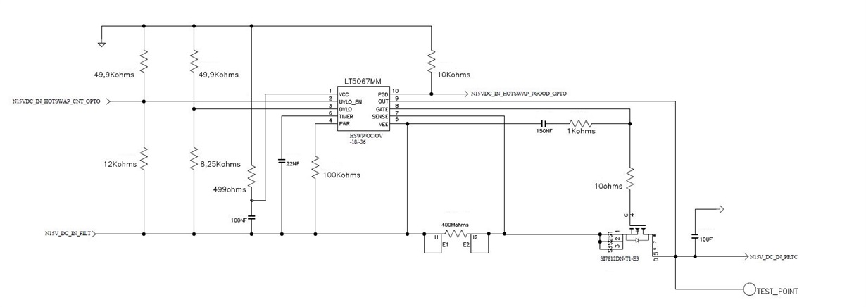

LM5067: current limit problem
Part Number: LM5067
I use a LM5067 for over current protection. According to datasheet, the calculation of current limit is 50mV / sense resistor.
I have a 100mohm resistor as a sens res. I expect the current limit is 50mV / 100mohm = 0.5A. But, the current limit occurs much earlier.
My operating voltage: -15V
