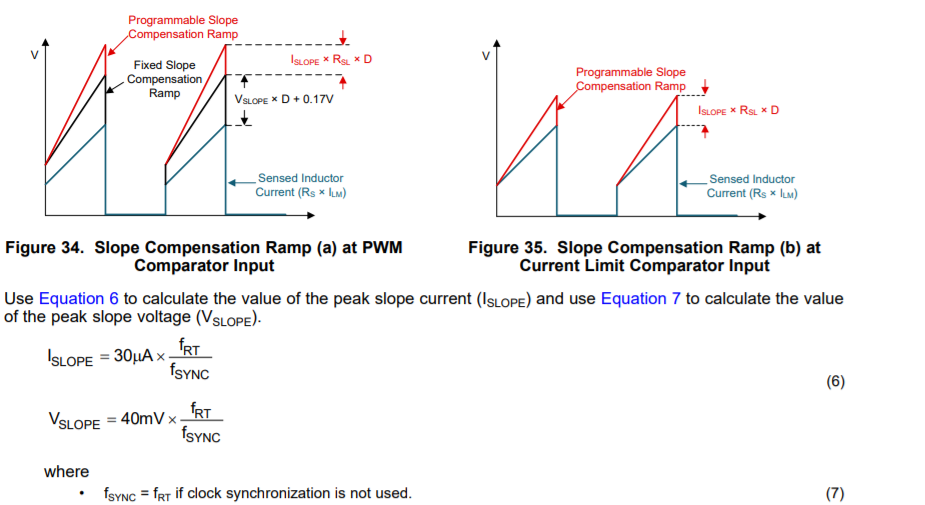

my customer is using the LM5155 to design the boost. We are curious about the slope compensation parameters below.
1. Why the Vslope is 40mv? No other information in the datasheet.
