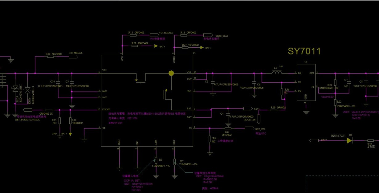

How is BQ24075 charging and discharging around 10mA after full charge?
It would be really helpful to see the scope capture of the charge current and battery voltage to examine what's going on.
Can you try to toggle the /CE pin after termination occurs and let me know if /CHG is high or low.
