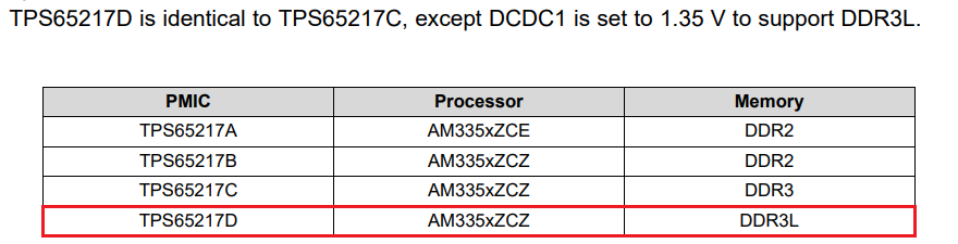

I'm just looking for PMIC for AM335X and I found TPS65217 and TPS65910. Let me ask a quick question.
Can TPS65217 and TPS65910 support power supply for DDR3L?

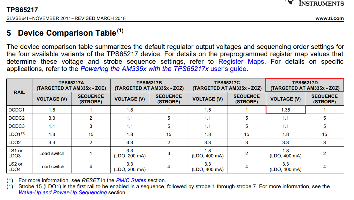

Yes, the TPS65217D can support the power supply for DDR3L (1.35V). Reference: Section 5 of TPS6517 datasheet.
This is also represented in the following user's guide: http://www.ti.com/lit/ug/slvu551i/slvu551i.pdf
You may also use TPS65218D0, which can also support DDR3L.
