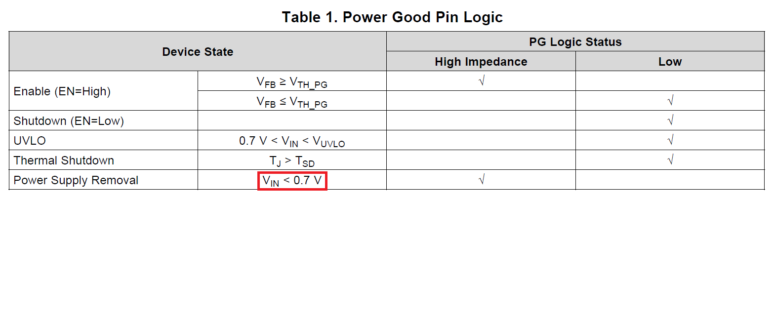

Will Power Good stay low all the time during power-down? Or just like the below table, when Vin drops below 0.7V, PG Logic Status is high impedance?
Hello user,
To have control over the logic of PG pin, VIN must remain present otherwise it cannot force the PG pin to stay low. As the device stops switching when Vin<Vuvlo, PG voltage will refer to Vout which will be discharged, so PG will be close to 0V..
