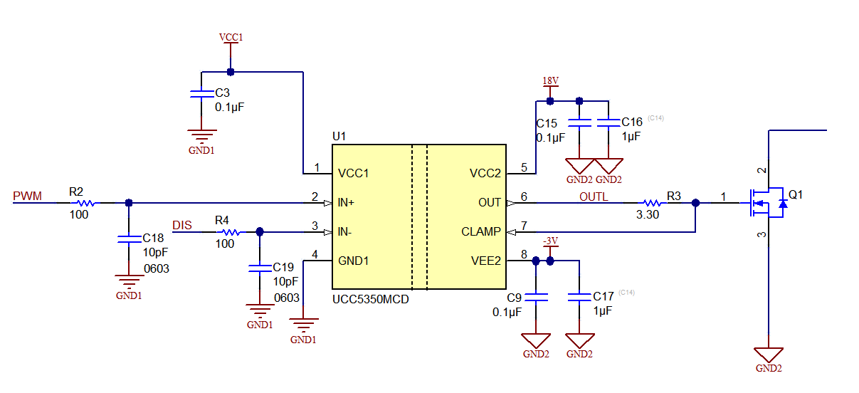

my customer want to use UCC5350MC with miler clamp.
  1. the driver power supply is +18V and -3V, could you help to draw the schematic how to connect UCC53x0MC with SiC MOSFET?
  2. What’s the response time of Miler Clamp?
  3. Customer need a disable pin, could he use IN+ or IN- as a disable pin?

    The connection of the UCC53x0MC device is very similar to the negative drive application circuits found in section 11.2.3.3. You can use a dedicated supply, or a zener drop circuit. See the schematic below for an example.
    The miller clamp is turned on when the gate-to-source voltage drops below the clamp threshold voltage (2.1V typ). We don’t have a spec for this, but it is controlled by a comparator which switches very quickly, and should be fully on before the drain-to-source voltage starts to slew.
    Please see this tech note, covering how to use the inverting input as a disable pin.
    http://www.ti.com/lit/an/slla423/slla423.pdf
