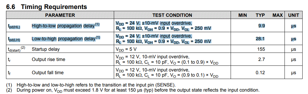

What are the min and max values of High-to-low propagation delay (tpdHL) and Low-to-high propagation delay (tpdLH)?
It does not have to be a guaranteed value.

Yuto-san,
It seems that we do not spec this delay min and max externally. I would use these typ values and the values may change slightly based on your test conditions or temperature.
Abhinav.
Hi Abhinav-san,
Thank you for your reply.
There is no problem if it is not a guaranteed value, so can you investigate the information?
Yuto Sakai
Yuto-san,
I will look into this for you, but I'm fairly certain this data does not exist. I would assume a general tolerance of +/-5% within the spec, but I'm not sure.
Abhinav.
Yuto-san,
There was no minimum or maximum data I could find, so I would assume a general +/- 5%. This may not include all temp ranges, but it will be a general range from the typ.
Abhinav.
