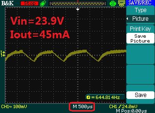

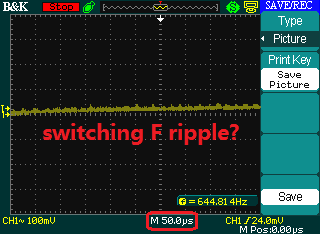

  • I attach the ripple waveform. the 1mm-1.5mm-1mm-1.5mm...... ripple is not switching frequency ripple (Rt=127K, F should be ~500K). Where does this 1mm ripple come from? The HighFrequenyRipple is superimposed on the 1mm period ripple (on the rising edge), is it the switching F ripple, seems match the WEBENCH file Vout p-p= 7.678mV

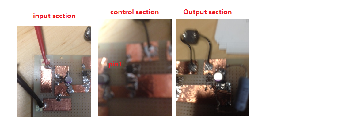

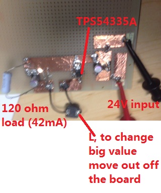

  • I notice that this time the slow frequency has equal period 1.25ms, before(in 3 days), it is always 1ms--1.5ms--1ms--1.5mm... I take my prototype photo again for you to analysis. I added 2 ferrite beads to isolate Vin and Input GND, doesn't help. I use jump wires to short them. Also I add ceramic cap 10uf + 0.1udf, doesn't help, removed.
  • I am wrong. the ripple frequency has nothing (less) to do with switching frequency. The I(L) can't be suddenly changed, so roughly take it as constant.  the ripple frequency mainly depends on Cout and Load R. (in my case, it is 120 ohm resistor),
    But I did add 3 Cout (total 4 x270uf = 1080uf), the ripple only drop from 160mV too 130mV.
    Here has a problem: Our application is to stepdown 24V DC to 5.1V to power a single-board computer, the load is not constant (don't know it is resistive load or combination). sometime it is heavy and sometimes it is light light. Will this circuit fit our application? if not, would you please recommend a buck circuit for us?
    The load current is about 45mA, the IC works in Eco-mode, the switch frequency is lower and inconstant, not 500kHz. The IC increases efficiency by reducing the switch frequency at light load. The output ripple would be larger because of the low frequency.  You can try to change 120ohm to 5ohm, the ripple is lower and the switch frequency is 500kHz.

    The layout of your board is bad, the spike voltage of PH is very large which would lead to damage of Low side MOSFET. You can check the waveform of PH.
    Shawn

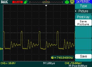

    At 60 ohm load(5.1V/60=85mA), I measure the PH waveform as attachment, which is similar to TPS5433xA Page33 Figure 31 (but the low ripple is big).

  • I replace the chip 3rd time. This time , with 3.75 ohm load, unlike previous cases, it immediately broke. this time the output is only 1.23V, and last for a couple of minute, then break.
    Please set the bandwidth of oscilloscope to 500MHz when you test the SW waveform, I think the spike voltage would be large.

    PH waveform is as below:

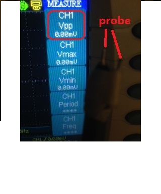

  • Scope shows VIN, BOOT, VSENSE, COMP, RT , PH amplitude all are in range with some margin. at Iout=1.092A
    So what is the root cause to cause chip shorted at heavy load?
    I can't see the waveforms.
    As I mentioned, you need to check the SW waveform, to see whether the spike voltage is too large, and the bandwidth of oscilloscope should be 500MHz.
