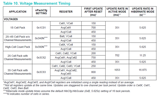

Hi Team,
Is  there a timing diagram that shows how long you need to wait until the internal register's are updated after a measurement is taken. I am looking for a similar table to the below  but for the  BQ34Z100-G1
  • Hi Julio,
    Unfortunately this information is not available for the bq34z100.
