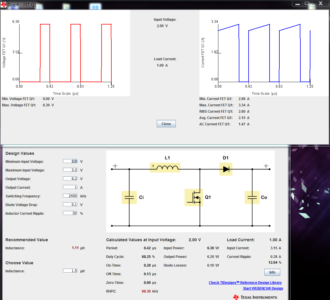

Here are my design parameters using a TPS63070:
Vin   = 2.0V - 3.2V
Vout = 6.2V
Iout  = 1000mA
Assuming 80% efficiency in boost mode, duty cycle D = 1 - [Vin,min x efficiency]/Vout  = 1 - [2.0x0.8]/6.2  = 74.2%

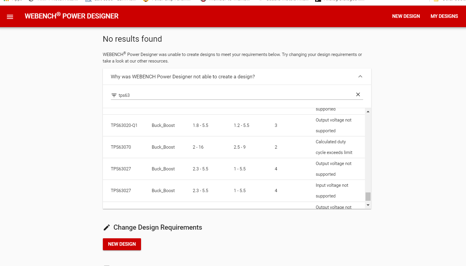

When I plug in the above numbers into WEBench, the online tool reports back that a design cannot be made due to "max duty cycle".  However, the TPS63070 does not have a max duty cycle specified in the data sheet;  so, this leaves me to wonder (a) Why is no max duty cycle specified in the data sheet?  (b)  Is it really the max duty cycle that is limiting this design?
Also, when I run the numbers for switch current inside TI Power Stage Designer, I find that the switch current stays below the 3.6A limit:
Hand calculations more or less match the above results +/- a few percent.
I'm confused.  It feels like I am missing something here because one set of tools and hand calculations are saying the design is possible with this PMIC, but WE Bench tells another story.  What is the true reason the TPS63070 cannot handle the above conditions?
  • Hi Adam:
    I thought it's caused by the current limit. Iin=Vout*Io/Vin/Eff=6.2V*1A/2V/80%>4A. It's exceeded the limit list in spec.
    You could have a look at TPS63802 with larger current capability. But it's still hard to support 1A/6.2V @VIn=2V.
    May you tell what's the application it is, and does it need 1A output current for all Vin range?
