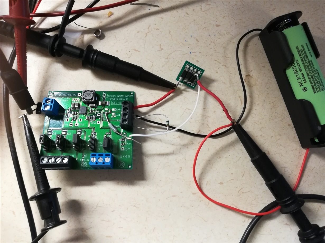

I am using the charger in an application where i have 3 series schottky diodes on the output of the charger and the feedback network is connected after the diodes to compensate for the diode drop. The charger is inside the battery pack and the cell is always connected after the 3 diodes. when i provide power to the charger, it goes into hiccup mode (different from the detection) and never recovers.if i short the diodes then the charger works normally. I need the series diodes for protection and cannot get rid of them.
Also, when the diodes are connected but the cell is disconnected, the charger enters the detection pulse mode and depending on what level of the pulse i connect the cell, it chargers or not. for example if i connect the cell when the pulse is at 0V it doesn't latch but when i connect the cell when the pulse is at the positive level, it engages and charges every time.
I am attaching the scope plot of the hiccup and also a snapshot of the schematic.
please help!

  • Hi Gaurav,
    I reproduced with 4.2V battery. I tried both PS on first and battery emulator on first.  Please see below.
    At V(BAT) < VSHORT, current is ISHORT = 35mA-65mA current source.
    At VSHORT < V(BAT) < V(LOWV), current is reduced to precharge current.
    V(BAT) is measured at FB pin.
    Jeff

    Also, below is the picture of my setup. can you please check if it is OK. i have connected a 10k between TS pin and Bat- to see if ti makes a difference but it doesn't.
    Thank you,
    Gaurav
  • Gaurav,
    Your setup looks like mine only I used MUR120 through hole diodes.  I did not measure on the input side of the diodes (BAT+ on the board) when there is no input power.  The BAT pin connects at BAT+ on the board.  The is a small leakage path [I(SLP) < 10uA] into the BAT+ and SNS pins.
    Jeff

    I have ordered another EVM that I will modify just to confirm mine was not a fluke.  I noticed that the feedforward capacitor C3 is still on your board connects before the diode to FB.  Can you remove and retry?
    Jeff
  • Jeff,
    So is this capacitor not populated on your EVM board?. can you send me a picture of your setup to compare?. I am wondering if i am missing some other things too.
    Thank you,
    Gaurav
  • Gaurav,
    Please see below.  Also, I do not have the feedforward diode installed.  If installed it would need to be after the diodes.  I have ordered new diodes and a new PC which I will use next week to reproduce.
  • Hi Jeff,
    You nailed it!. it was in-fact the feed-forward capacitor causing me all this grief.
    Thank you for all the hard work you put in to support this application. I consider this issue closed.
