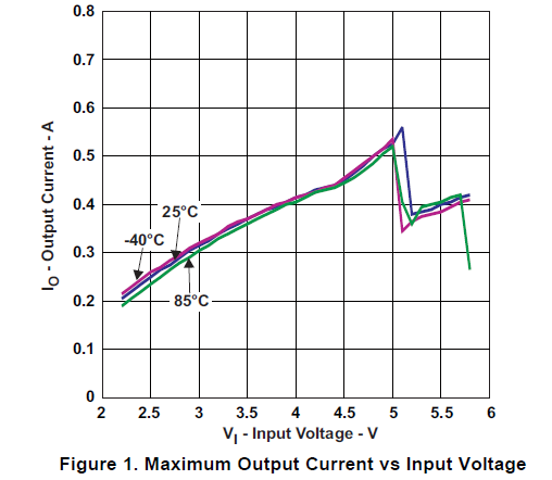

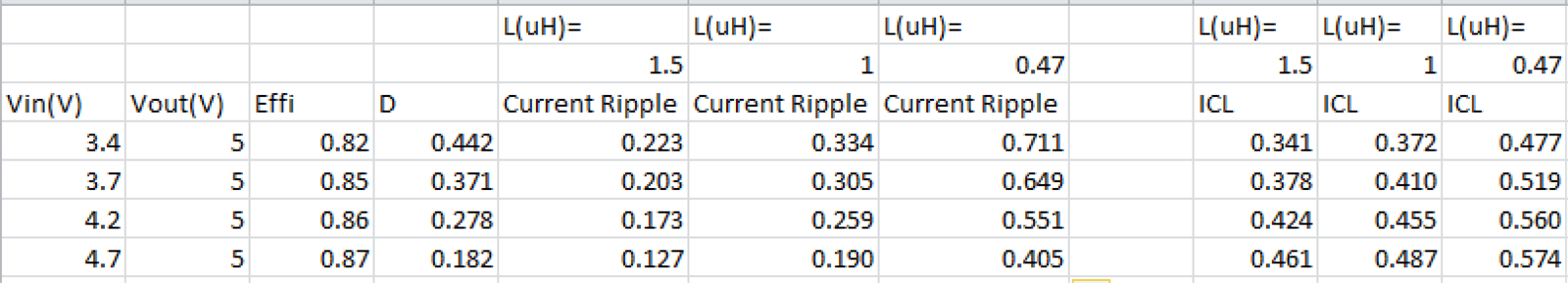

I use IOUT(CL) formula which in data sheet to calculate the IOUT(CL) as below.
VIN=4.7V, VOUT=5V
Finally, the IOUT(CL)=0.626A
BUT the figure 1 shows the Iout can't over 0.5A at Vin=4.7V
Could you let us know the detail why Iout can't over 0.5A at Vin=4.7V ?
