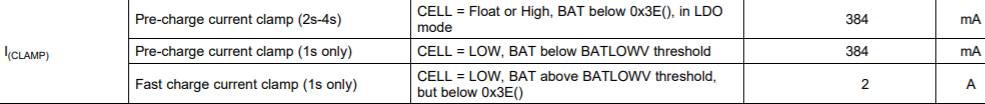

I went quickly through the BQ24773 datasheet but I couldn't find any section related to the typical chargin profile (more or less the same for all the chargers).
In particular the precharge timer details.
hope you may prove me wrong :)
thanks a lot in advance
KR
Vincenzo
  • Hi Vincenzo,

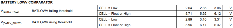

    The pre-charge current information is given in the EC table. Section 8.6.6 in the datasheet also provides some further explanation on this.
    When VBAT < BATLOWV (for 1-cell charging) or VBAT < VSYS_MIN (for 2-4 cell charging), the battery charge current is clamped below 384 mA. VBAT must rise above these voltage thresholds in order for the BQ24773 to apply the full fast charge current.
    Angelo
