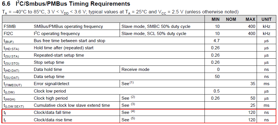

Hi team,
I want to check why the UCD9090A spec for the Tr and Tf is more strict than normal I2C(1000ns)? Do youhave some ideas here? Thanks,
