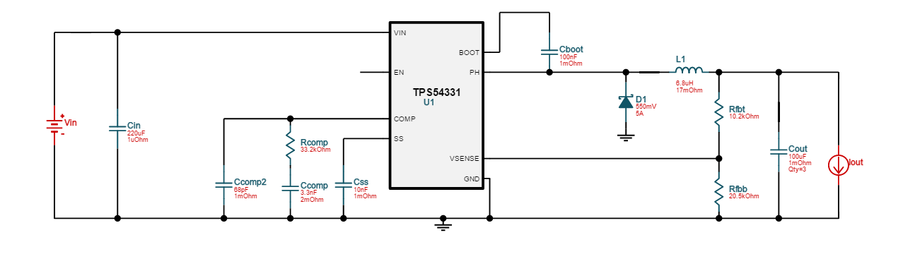

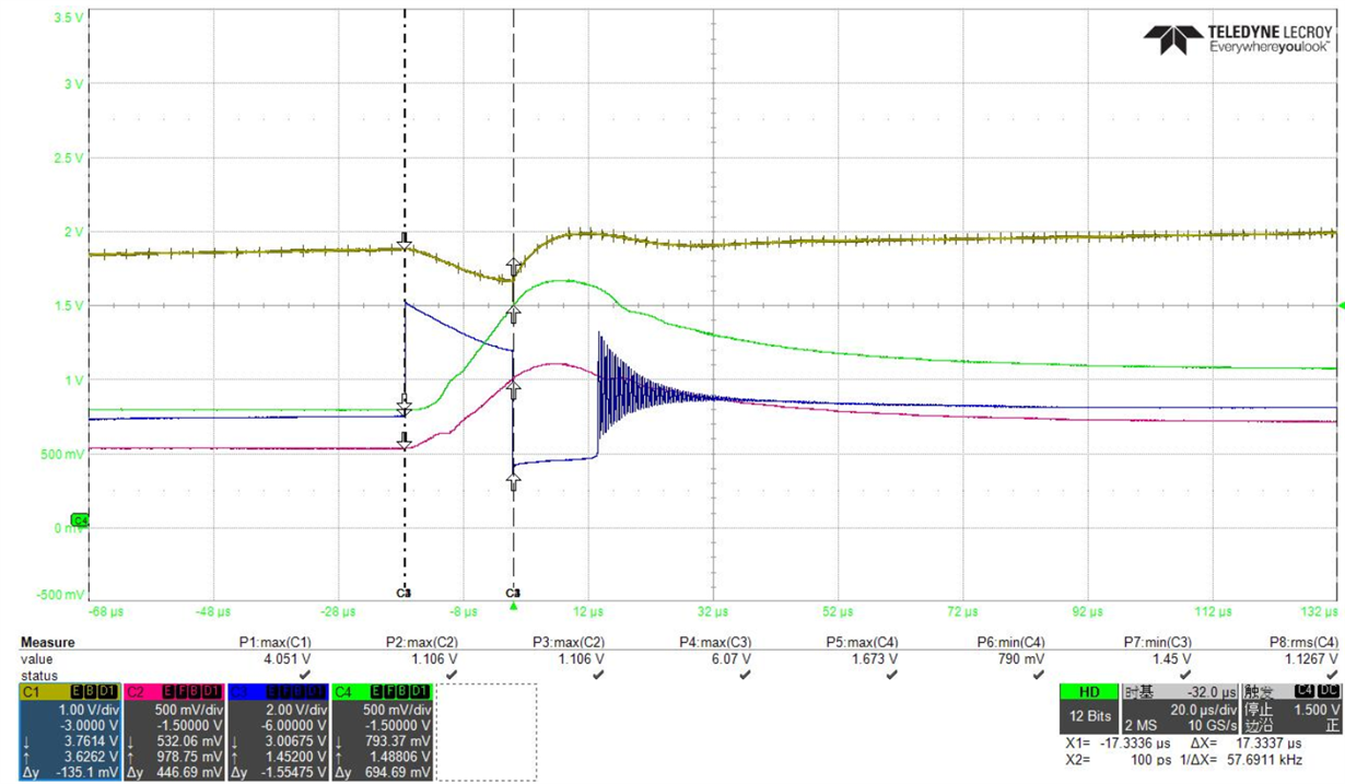

               I am using TPS54331DR as 5V to 1.2V buck convertor,and when 5V  power off ,1.2V output have big ripple and 1.2V output can run to 1.6V.
              My circuit as bellow:
The waveform as bellow
CH1:5V Vin CH2:TPS54331DR Comp Voltage CH3:TPS54331 Vsense CH4:1.2V Vout
When 5V Vin shutdown with ripples,and 1.2V Vout also have ripple and the 1.2V Vout over shoot can as high as 1.6V.
Zoom the 1.2V Vout Over shoot waveforms as bellow :
Please help to solve the 1.2V Vout Over shoot problem ASAP.

    The inductance is a little large, it would be better to change it to 2.2uH. But I don't think the issue is caused by the inductor. Could you please share the layout? Let's review it.
    And please test SW waveform, it would be better for us to understand what happened during shutdown.

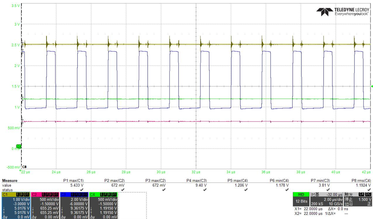

                   The normal waveform as below when 5V VIN is stable.
    CH1:5V Vin CH2:Vboot to GND Voltage CH3:Vcomp to GND Voltage CH4:1.2V Vout
    When 5V Power off,and the 1.2V Vout over shoot waveform as bellow :
    You can see that 1.2V Vout can get to 1.673V

    As I mentioned, could you please share the layout? If the layout is not good, and it is easy to introduce noise.
    And where the 5V voltage comes from? How did you do the shutdown test?
