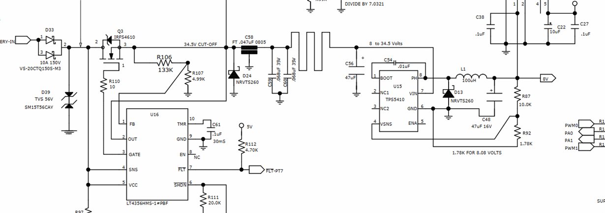

I am doing a redesign for a production ECU to replace obsolete parts and I chose the TI TPS-5410 regulator to save complexity and reduce some of the switching noise on the prior design. However, the new TI part is terrible. I am getting about 72 dB of switching noise conducted back into the power source, along with a second harmonic at twice that frequency. I am also disappointed that TI does not / did not offer any support other than this forum. Attached is a partial schematic of the power supply section and a spectrum plot of the noise.Any suggestions would be appreciate, the need is urgent.
