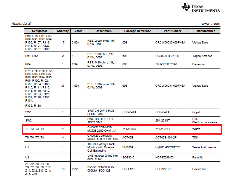

We will reference design TI BQ76PL455A-Q1 EVM for Automotive, but we just check 744242471, It`s cannot support AEC-Q200 and IATF16949 spec, have other P/N can suggestion?
if any suggestion, Please advise me.

    We do not have any formal recommendation for another choke, but there are many similar parts out there with similar specs - the important ones being the inductance and high impedance at frequencies that may be noisy in your system.
