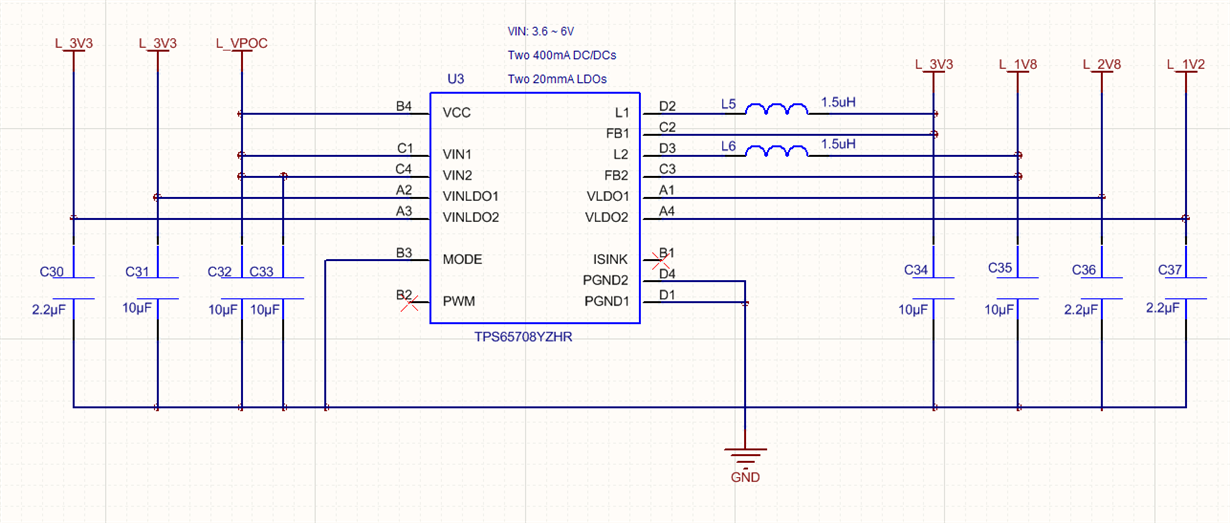

What would be power sequence if both LDOs are powered from DCDC1? please find my schematic attached.

Are you referring to section 8.3.9 Power-up Sequencing section in the datasheet page-14?
If so, this device is set to option-2. i,e DCDC1 starts first and once its power good LDO1 starts. Once LDO1 is up and running DCDC2 is enabled. Once DCDC2 power good is released LDO2 is released.

Hi Sam,
Murthy is correct, the sequence will be 3.3V -> 2.8V -> 1.8V -> 1.2V.
LDO2 is not enabled until DCDC2 indicates power-good, regardless of the source for VINLDO2.
