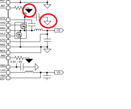

Hi, Team,
I have a basic question for TPS6508640. Could you please let me know the difference between the black GND and white GND?

I think black ground is Analog ground (AGND) connection and white ground is power ground (PGND) connection. Please refer to the datasheet page-112, section: 7.2.1.4.1 Layout Guidelines for more details on how to connect these GND's on the PCB layout.
I have forwarded your question to the device expert and he will provide the additional feedback if my assumption is not correct or if you have additional question on this topic.
